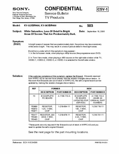

Preview for : Sony KV-32XBR400 KV-36XBR400 Symptom: In bright areas of scenes that are predominately dark, the picture may be excessively
white and/or bright. This may result in a loss of picture detail in the bright areas.
Conditions under which the symptom may appear:
1- In the full screen mode, when playing a 480p source (like progressive-scan DVD).
2- In Twin-View mode, when playing a 480i source on the right-side window while TV,
VIDEO-1, VIDEO-2, VIDEO-3, or VIDEO-4 is selected for the left-side window.
(pag. 2)
