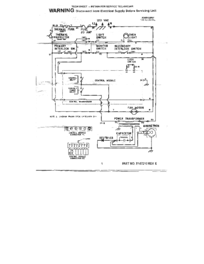

Preview for : Whirlpool MW8550XS Troubleshooting diagrams for Whirlpool microwave MW8550XS that was included inside microwave case. This is the manual provided by Whirlpool for technician that is printed on a piece of Tyvek.
