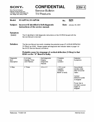

Preview for : Sony KV-32FV16 KV-32FV26 Symptom: The IC identified in Self-diagnostic instructions on the CD-ROM issued with the Service Manual is incorrect. - pag. 1
Back to : bulletin_TVP0521_®_.pdf | Download bulletin_TVP0521_®_.pdf | Home
