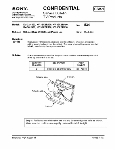

Preview for : Sony KV-32HS20, KV-32XBR400, KV-32XBR450, KV-36HS20, KV-36XBR400, KV-36XBR450 Symptom: Degauss coil vibration during degauss operation at power on causes a buzzing or rattling noise to be heard from the cabinet. This noise is beyond the normal hum that is briefly heard during the degauss operation - pag. 2
