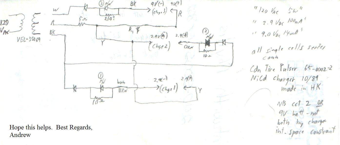

Preview for : Canadian Tire Pulser 65-0002-2 Extremely simple schematic for NiCd battery charger model 65-0002-2, made in Hong Kong for Canadian Tire corp. in 1989. Specs: 120 Vac 5W in, 2.9 Vdc 100 mA & 9.0 Vdc 14 mA out. Note that charge circuit 2 cannot be used at the same time that a 9V battery is being recharged but this may be a simple mechanical design problem not an electrical limitation (esp. since the 9V charge current is low). Hope this helps. Andrew
Back to : Pulser 65-0002-2 NiCd Cha | Download Pulser 65-0002-2 NiCd Cha | Home
Hope this helps.
