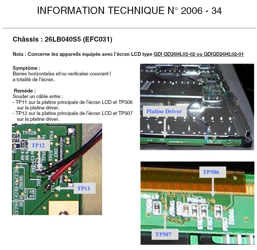

Preview for : Thomson 26LB040S5 Bulletin (Information Technique 2006-34) for fixing stripes and blue discoloration on LCD panel QD26HL02, which was als used in Philips 26PF3320.
Back to : QD26HL02 panel stripes - | Download QD26HL02 panel stripes - | Home
