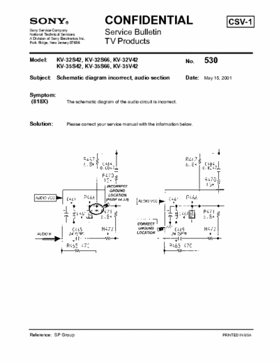

Preview for : Sony KV-32S42, KV-32S66, KV-32V42, KV-35S42, KV-35S66, KV-35V42 Symptom: The schematic diagram of the audio circuit is incorrect - pag. 1
Back to : bulletin_TVP0530_®_.pdf | Download bulletin_TVP0530_®_.pdf | Home
